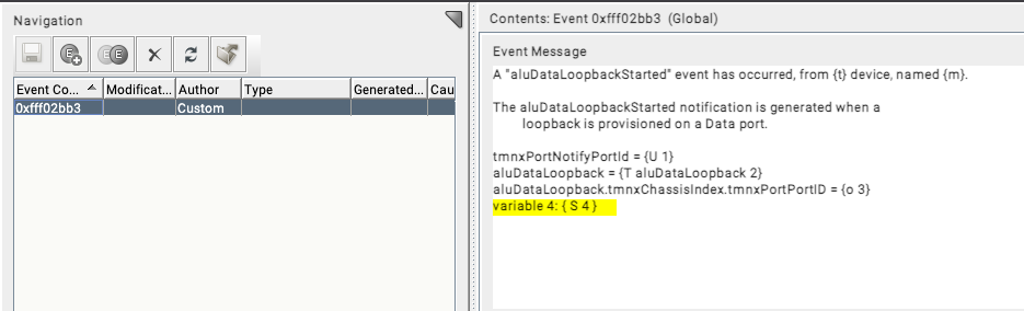

Note: Used the ifName/0x11f60 attribute at the device level.
When implementing  you would need to change 0xfff02bb2 to your mapped event id, create a new event id replace 0xfff02bb3 with your new event ID.
The Event Format Message can be added to display the ifName from Variable 4
