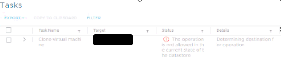

  • Unable to clone any VM in the cluster
  • Cluster has Storage DRS enabled
  • VM cloning task fails with the below error:
  • Below error can be seen in /var/log/vmware/vpxd/vpxd.log in vCenter Server Appliance:
yyyy-mm-ddTss:ss:ss.070+02:00 error vpxd[####] [Originator@### sub=Default opID=######] [VpxLRO] -- ERROR task-#######-- vm-<vm_id> -- vim.VirtualMachine.clone: :vim.fault.InvalidDatastoreState
yyyy-mm-ddTss:ss:ss.531+02:00 error vpxd[#####] [Originator@### sub=VmProv opID=#####] Local-VC Full Clone failed at vpx.vmprov.SelectDestination for poweredOn VM 'VM_name' (vm-id, ds:///vmfs/volumes/UUID/VM/VM_name.vmx) to new name <VM name> on host-ID in pool resgroup-ID with ds ds:///vmfs/volumes/UUID/ to (DstLocation null) with fault vim.fault.InvalidDatastoreState
VMware vCenter 8.x
ESXi 8.x
This issue occurs when the datastore is in maintenance mode or is not accessible/readable
Exit the datastore out of the maintenance mode or remove datastore if it is no longer required
