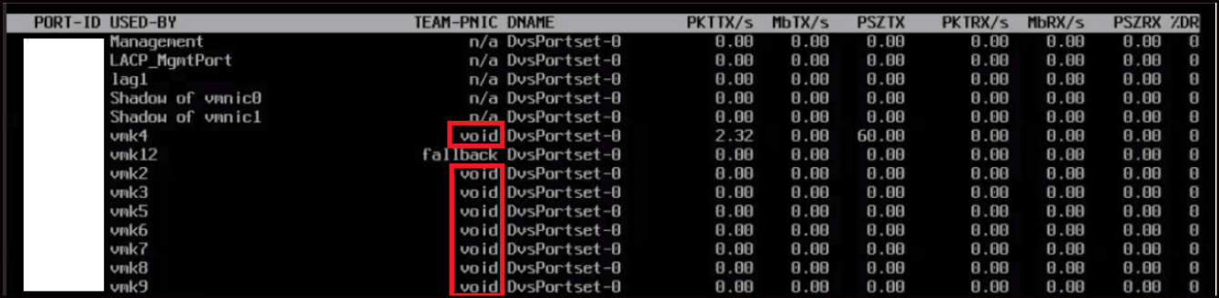

The issue is caused by the failure of communication between vSAN hosts, and assigned vSAN vmnic reporting as 'void' in esxtop.
In esxtop, an interface appearing as "void" indicates that the physical NIC has experienced a "Link Down"or a driver/firmware crash, causing the VMkernel to lose its uplink to the physical switch.
Where vmk4 used for vSAN traffic communication.
