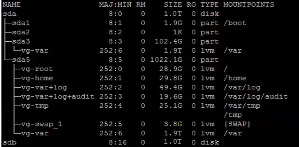

  • Command Line: Running lsblk shows the disks exist as block devices but are not associated with a partition or Logical Volume Manager (LVM) group:
    1. Log into VM in question using SSH with the support user.
    2. Switch to ubuntu user context, with the command:
      ub
    3. Run command to show the disks exist as block devices but are not associated with a partition or Logical Volume Manager (LVM) group:
      lsblk
      As seen in the example output below, "sdb" is not integrated into vg-var:
