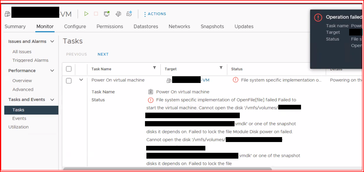

Symptoms:
Virtual machine (VM) will not power on with the error.
File system specific implementation of OpenFile[file] failed Failed to start the virtual machine. Cannot open the disk '/vmfs/volumesvm file path/vmname.vmdk' or one of the snapshot disks it depends on. Failed to lock the file Module Disk power on failed.
