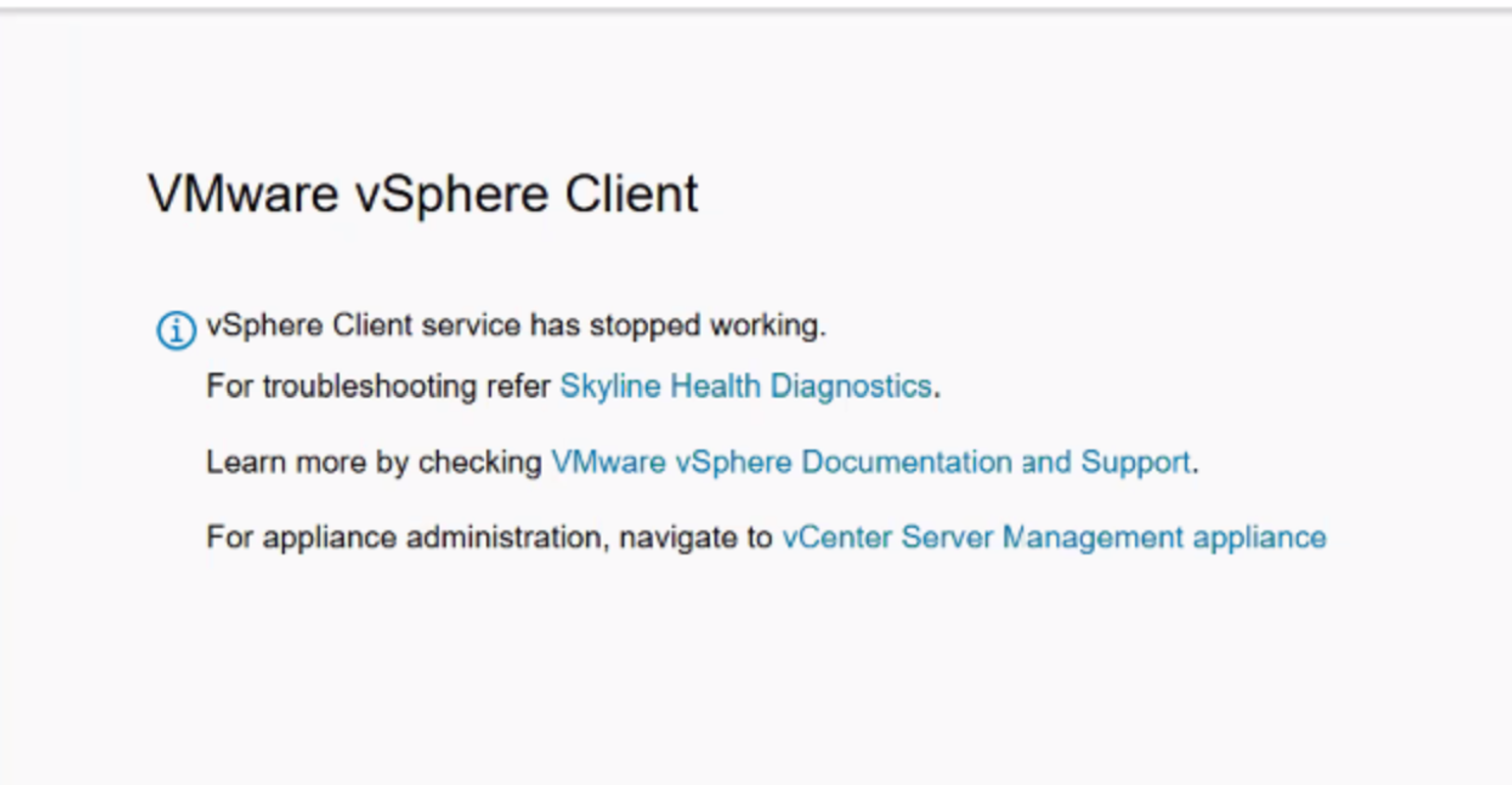

  • The vCenter Server Web Client is inaccessible.
  • Browsers display the following timeout error:
    "This site can't be reached. <vcenter_fqdn> took too long to respond."
    or
    "vSphere Client service has stopped working"
  • The Default Gateway is not pingable from the vCenter Server command line.
  • The vCenter Server IP address and the Jump Host IP address reside on different subnets.
  • The environment is identified as air-gapped or highly secured.
  • Nslookup from Jump server to vCenter server do not list the valid output.
