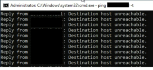

  • VMs in the same subnet and VLAN hosted on different ESXi hosts are unable to ping each other.
  • Initiate the pings from source VM to destination VM and the pings do not go through:
