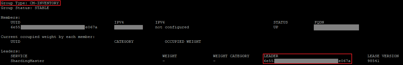

  3. Find the node that is a leader for "Group Type: CM-INVENTORY":
    > get cluster status verbose
    Sample output:
  4. SSH to the leader as root.

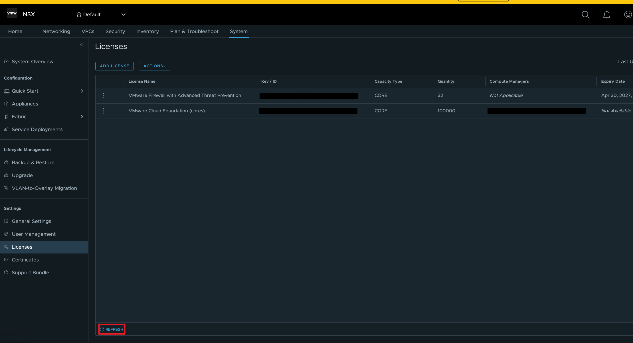

  6. Login this NSX Manager's UI (you can use any node, or the VIP), browse to System - Licenses, and click "REFRESH" button to trigger license sync.
    It will spend about 5 minutes in this step.
  7. After the "Refresh" operation finishes, reload this license page to confirm that the existing VCF license is removed.
  8. If the existing VCF license is removed, remove iptable rule to restore the connection:
  9. Return to the SSH session used in step 5.
    iptables -t raw -D OUTPUT -d {vcIP} -j DROP
  10. Return to the UI, click "REFRESH" link button to trigger license sync.
    After "Refresh" operation finishes, you may need to reload the license page to confirm the new VCF license is retrieved.
