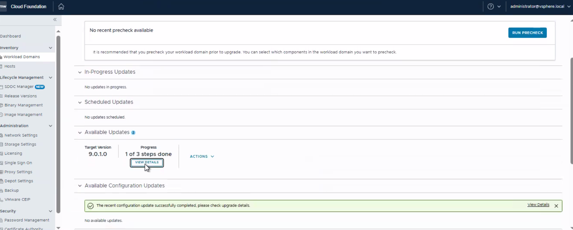

  1. Navigate to the Updates tab on the Workload domain in SDDC Manager.
  2. Under Available updates, the option to initiate vCenter Server upgrades is missing; instead, the message "No Available Updates" is displayed.
