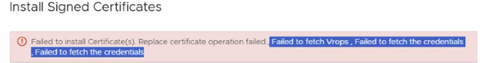

While renewing vCenter Certificates from SDDC manager, getting error "Failed to install Certificate(s). Replace certificate operation failed, Failed to fetch Vrops, Failed to fetch the credentials"

Error message in SDDC Manager :
