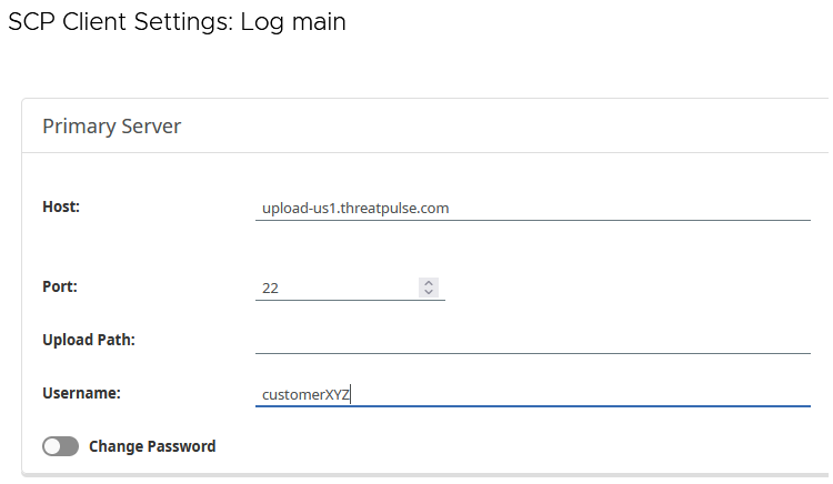

But the admin, during the Hosted Reporting service initial wizard setup has to chose and set only one. Then the Edge SWG SSH client has to be set to reach out for the specific region server (host), example "upload-us1.threatpulse.com":
The Edge SCP client set host is not matching the Cloud based Hosted Reporting service initial wizard chosen region
Log into the Enterprise portal console, click on "Subscriptions", then on the "Hosted Reporting" in the configured subscriptions tab. In the pop-up panel "Environments" tab check that the configured country for the environment is matching the Edge SWG set host server region (example: country Belgium then the host server has to be "upload-eu1.threatpulse.com").
If the initial wizard chosen zone (US, EMEA, etc.) has to be changed please create a technical case sharing the details. The Cloud SWG DevOps will carry out the change in the Cloud SWG Hosted Reporting backend
