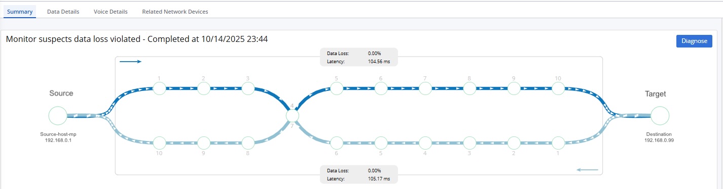

A violation/s is shown in scheduled report:
However, in diagnostics, it is not showing at which hop the violation occurred:
Appneta
Diagnostics are not guaranteed to see the same loss that triggered an alert, since it depends on:
  1. Whether the same path is traversed,
  2. What the protocol used was
  3. and whether the loss is sustained.
We are working on diagnostic replacement with hop-forwarding loss detection to look at better reflecting the errors however, at the moment, this is the way it works.
