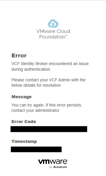

1. When trying to log in to VCF Operations using SSO, the following error is shown:
ERROR:  VCF Identity Broker encountered an issue during authentication.  Please contact your VCF Admin with the below details for resolution."

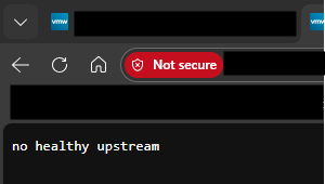

2. After rebooting all vIDB nodes and retrying to log in again, the error "no healthy upstream" is shown.

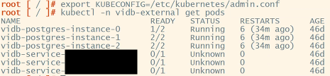

4. Execute the following command to check the pods' status.
    kubectl -n vidb-external get pods
    Note: The above output shows vidb-postgres-instance-0 is NOT 2/2 fully ready yet.

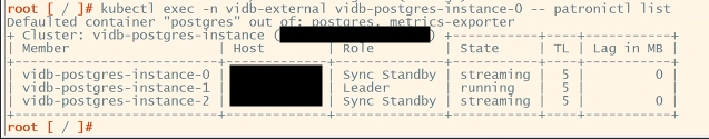

5. Execute the following command to confirm nodes are in the proper state. In the State column, the Leader instance should show "running".  The other 2 replica instances should show "in archive recovery", "starting", or "streaming" instead of  "start failed".
  kubectl exec -n vidb-external vidb-postgres-instance-0 -- patronictl list
6. In the above output, note the member/instance name in the first Member column for the Leader and Replica nodes. In the above screenshot, the Leader node is vidb-postgres-instance-1, and the other two instances are for the replica nodes.

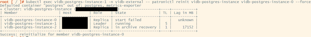

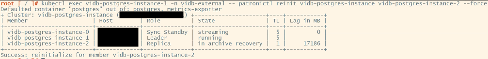

7. Execute the following commands to reinitialize both replica nodes' postgres services. Wait a few minutes for the status to change.
  kubectl exec vidb-postgres-instance-1 -n vidb-external -- patronictl reinit vidb-postgres-instance vidb-postgres-instance-0 --force
  kubectl exec vidb-postgres-instance-1 -n vidb-external -- patronictl reinit vidb-postgres-instance vidb-postgres-instance-2 --force
    Note: The above step should clean up the 100% partition.

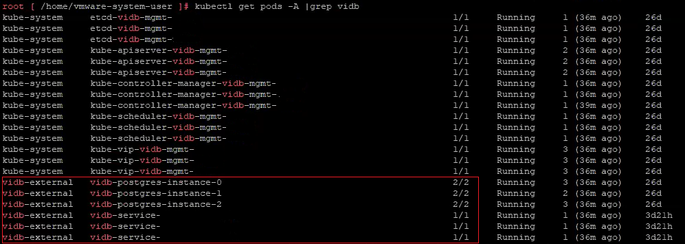

9. Execute the following command to review and ensure all vidb pod service statuses are running.
    kubectl get pods -A | grep vidb
