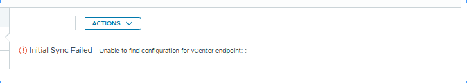

  • Also see the following error:
    Initial sync Failed: unable to find configuration for vCenter endpoint
