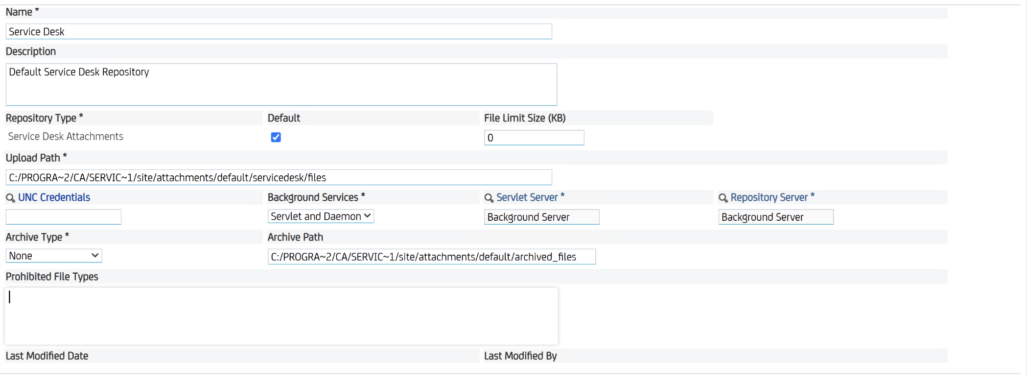

Audit team reported possible vulnerability threat from the files that are attached to the CA Servicedesk Manager ticket.
1.Upload files containing malicious scripts can be executed by the server, giving the attacker control over the server.
2.Data Exfiltration: Attackers can use uploaded files to read, modify or delete sensitive data.
3.Client-Side Attack: Harmful files, such as HTML or JavaScript and CSV, can be delivered to users, leading to cross-site scripting (XSS) or other client-side attack.
Release: CA Servicedesk Manager 17.4.
CA Servicedesk Manager has no inbuilt tool to scan any files that attached to the tickets.
Recommendation is to  restrict files based on the file type under prohibited file type section:
Step1 : Administration tab-> Attachments-> Repositories
https://techdocs.broadcom.com/us/en/ca-enterprise-software/business-management/ca-service-management/17-4/administering/configure-ca-service-desk-manager/establishing-support-structure/how-to-set-up-the-attachments-library.html
