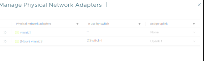

    • Click Manage physical adapters
    • Click on the Vmnic that is going to be moved under assign uplink and change it to none (this will detach the vmnic from this switch) and click ok
    • Click on the newly created Distributed Virtual Switch and click on manage physical adapter
    • add the vmnic to the new switch
    • Once added, click the 3 dots and migrate networking
    • Select the vmnic that we just added, click next
