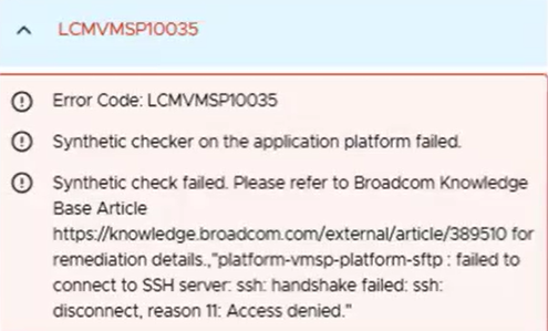

  1. Once the credentials are changed on the SFTP in Fleet Manager, a synthetic check failure event is observed while saving the setting for SFTP configuration.
  2. We see the same error when we cURL to the SFTP Host from VCFA/VIDB:
    Command:
    curl -k https://<sftp-host-ip>:30006/status
    Error message seen in the Output:
    platform-vmsp-platform-sftp":{"ok":false,"lastError":"failed to connect to SSH server: ssh: handshake failed: ssh: disconnect, reason 11: Access denied.","timestamp":"2026-06-15T03:00:15Z","duration":"90.861561ms","contiguousFailures":1,"lastTransitionTime":
