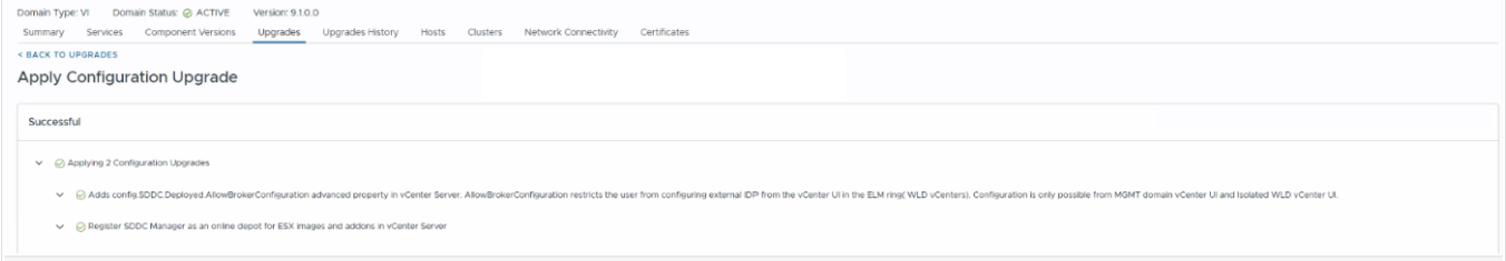

  1. Log in to the SDDC Manager portal.
  2. Navigate to Workload Domains > [Affected Domain] > Configuration Updates.
  3. Locate the drift item: AllowBrokerConfigurationConfigDrift.
  4. Select the item and click Remediate to apply the update.
  5. Once remediation is complete, verify the vCenter advanced setting config.SDDC.Deployed.AllowBrokerConfiguration is now True.
  6. Return to VCF Operations > Fleet Management > Identity & Access and retry the SSO Configuration.
