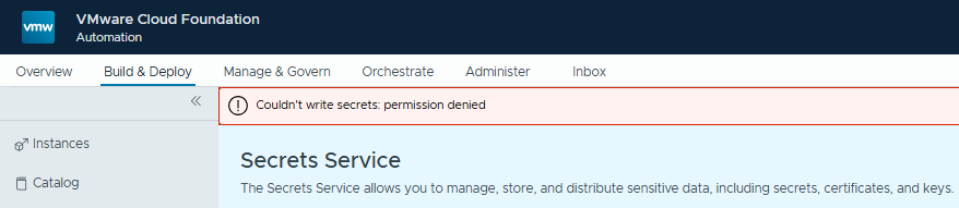

  • In VMware Cloud Foundation Automation (VCFA), viewing or creating a secret/key value secret fails with the banner "Couldn't write secrets: permission denied"
