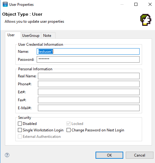

After upgrading to SCM v14.5.0, we find that if a user's account is locked out, we cannot unlock it using the Harvest Administrator Tool.  The "Locked" checkbox is checked, but disabled.
Harvest Software Change Manager v14.5.0
This problem is fixed with the 14.5.01 cumulative patch.  When the checkbox is checked, it is enabled which allows the Harvest Administrator to clear the checkbox to unlock the user.
