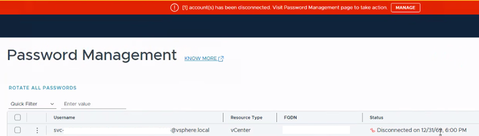

Password rotation tasks complete successfully, but the account status remains "Disconnected."
VMware Cloud Foundation 5.2.x
VMware Cloud Foundation 9.x
SDDC Manager 5.2.x
SDDC Manager 9.x
VMware vCenter Server 8.x
vCenter 9.x
A password validity value of 0 returned by the vCenter API caused the SDDC Manager to incorrectly display the service account expiry date as 1970-01-01.

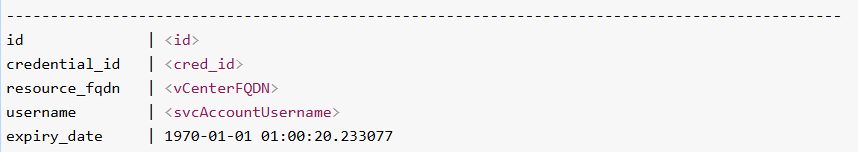

Validate the service account expiry:
SSH to the SDDC Manager with vcf and elevate to root using su.
Access the database, and execute the following select query:
psql -h localhost -U postgres
\c operationsmanager
select * from passwordmanager.credential_expiry where resource_type='VCENTER';
Note: Verify the output against the example below. If it does not match, run \x to enable "Expanded display" and repeat the query.
