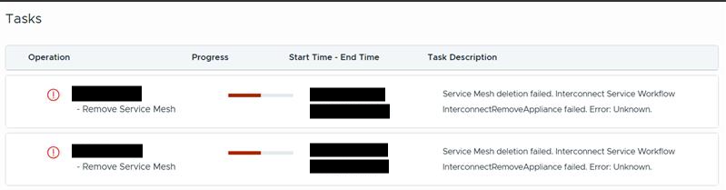

  • Force delete fails to remove the Service Mesh.
    • Service Mesh deletion failed. Interconnect Service Workflow InterconnectRemoveAppliance failed. Error: Unknown.
