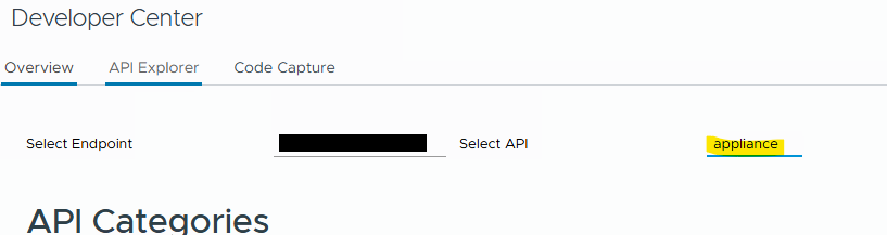

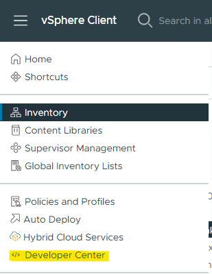

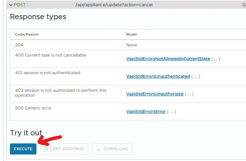

Workaround:
POST api/appliance/update?action=cancel" under "update"POST api/appliance/update?action=cancel (press the EXECUTE button and CONTINUE)
