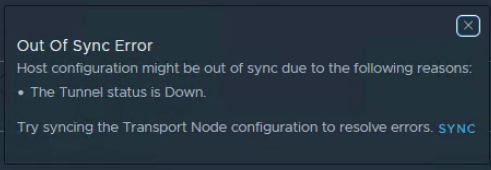

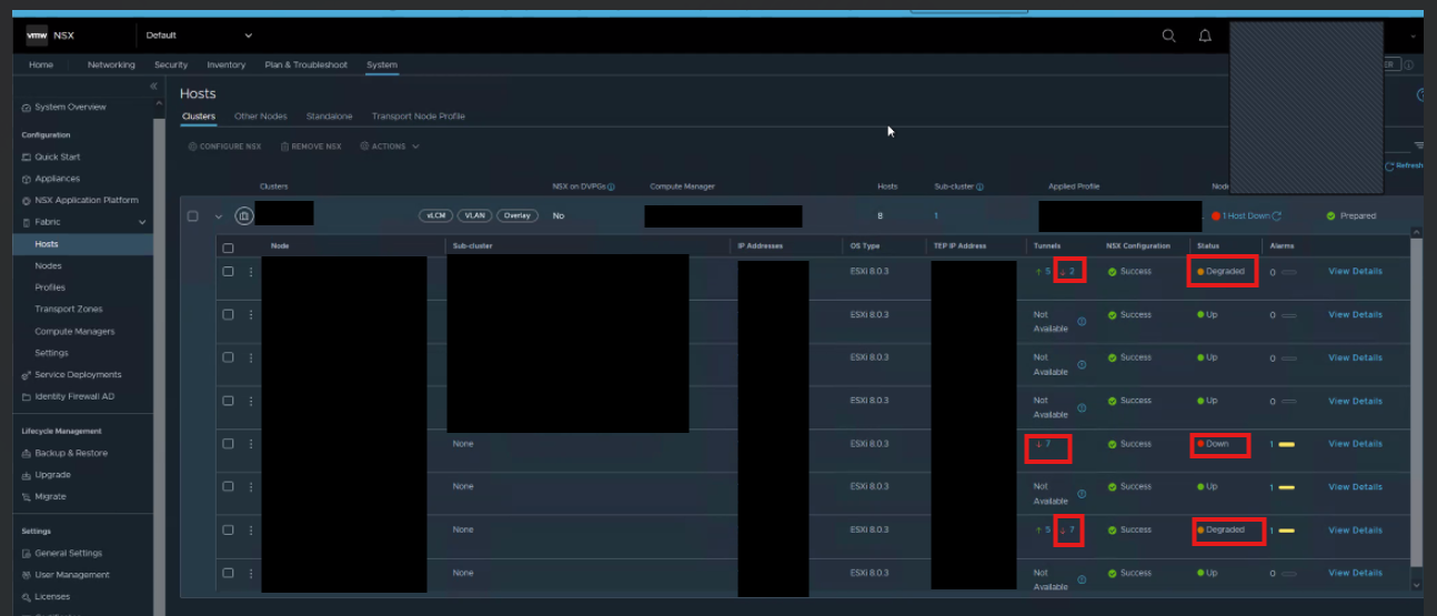

  • Tunnels are showing down
  • Hosts are showing degraded
  • Tried to 'Sync" the host
This condition can occur when the host configuration becomes desynchronized from the NSX Manager, or after a failed upgrade/remediation where the TEP interfaces fail to initialize correctly on the host's virtual switch.
