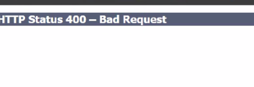

  • or the login fails with the error
    https status 400- Bad Request
