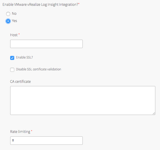

Both environments are configured as expected where the respective fields are correctly configured pointing to same VIP from VMware Aria operations for Logs

cat /var/vcap/jobs/pks-vrli-control-plane-fluentd/config/fluent.conf    ### verify if VMware Aria operations for Logs is configured and the host and agent ID are present
<match **>
  @type loginsight_buffered
  host <FQDN>
  port 9543
  scheme https
    ca_file /var/vcap/jobs/fluentd/config/vrli_ca_cert.pem
    ssl_verify false
ping <FQDN of VRLI>                                                                                  ### confirm the IP
