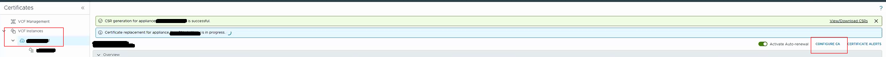

You are able to auto renew certificate via the configured Microsoft CA integration on the Management domain.  However, when you try to auto renew the certificates on the workload domain, the task failed with Error:
"Certificate replacement for appliance workload.example.com has failed.  This is a task for REPLACE_CERTIFICATE of an appliance"

  • Go to Fleet Management > Certificates > VCF Instances > <Workload Instance>
  • Click on "Configure CA"
  • Update and Save the configuration. Ensure the configuration is consistent with the configured Microsoft CA integration on the Management Domain.
Once Microsoft CA integration is updated, the certificate renewal will complete successfully.
