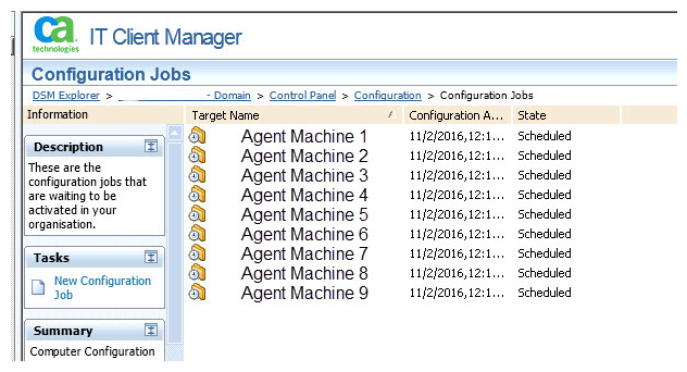

If you look in DSM Explorer >Control Panel > Configuration > Configuration Jobs
If for some reason the machines are not contactable the Configuration Job
for that agent can be left in an ERROR state.
If there are too many agents left in an ERROR state it can keep new Configuration Policies from being Applied.
All you need to do is too delete the Configuration Jobs and that will allow the Configuration Policies to get Applied.
