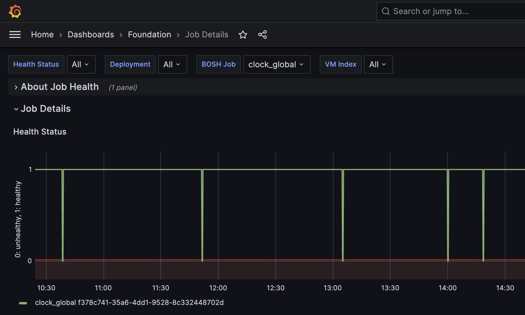

When checking HealthWatch grafana Health Status charts, you may see the line going from healthy to unhealthy, very quickly, as in the below screenshot.
Health Status line will go down whenever any process monitored by monit is not running. In this case, the process restarts very quickly, so when you do "monit summary" in the VM, everything will likely be up and running, so you don't know what failed from that output. E.g
