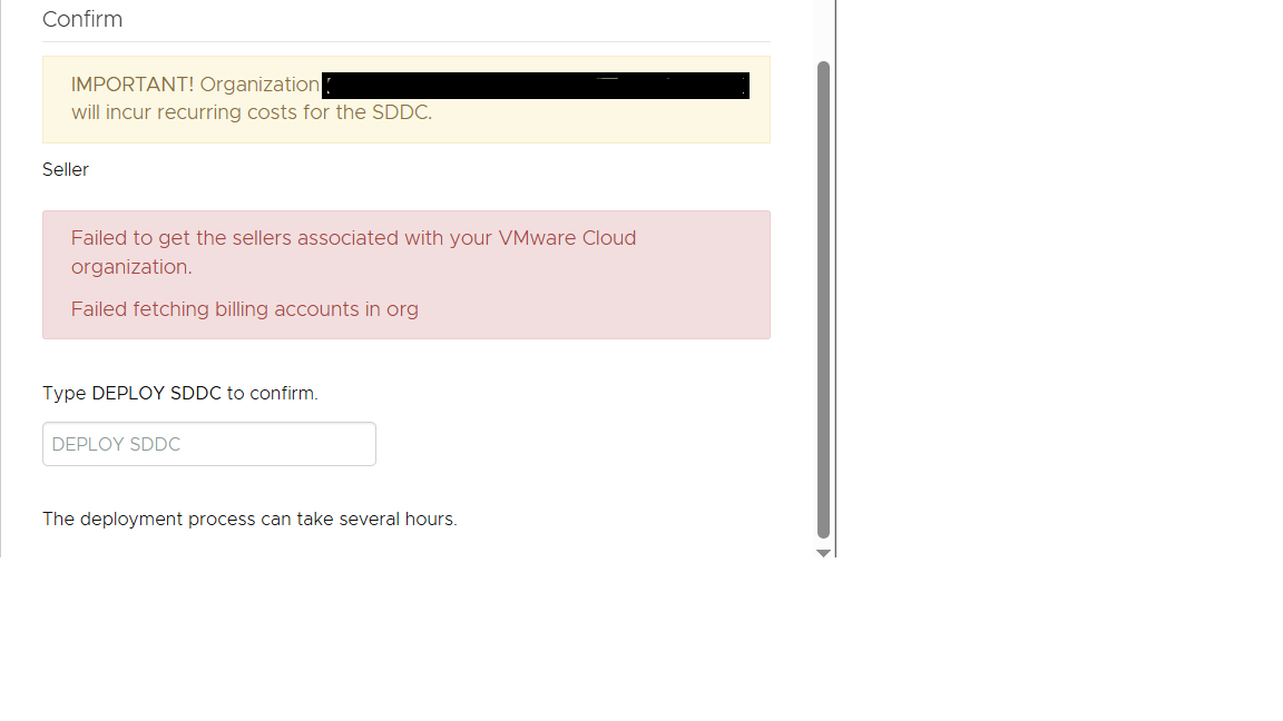

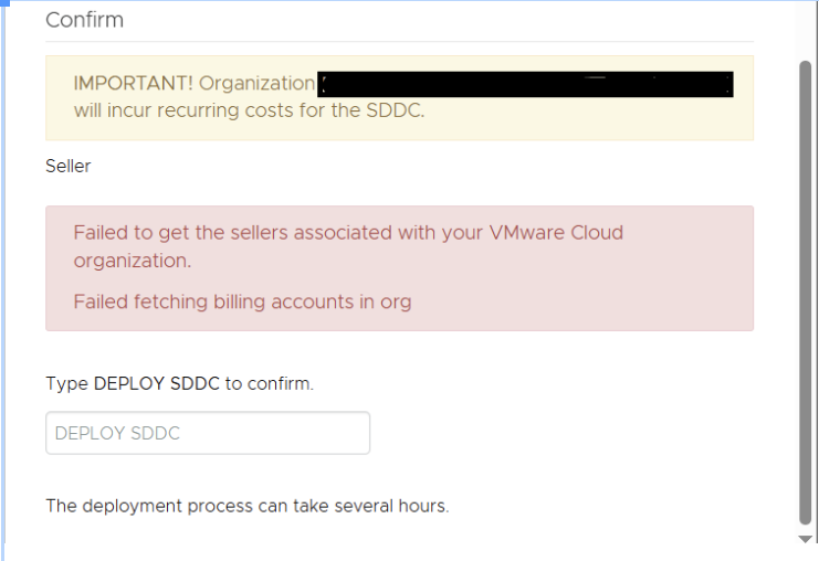

Deploying a new recovery SDDC in VLCR will fail with error "IMPORTANT ! Organization "Org_name" will incur recurring costs for the SDDC" and "Failed to get the sellers associated with your VMware cloud organization". Refer below screenshot
VMware Live Cyber Recovery 7.27.x.
This is because of the missing seller information and this parameter is not supported in the new Broadcom saas console.
The is a known issue and is being worked upon currently. Please refer the updated VMware Live Cyber Recovery release notes
