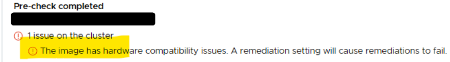

  • The following error appears during remediation pre-check:
    The image has hardware compatibility issues. A remediation setting will cause remediations to fail."

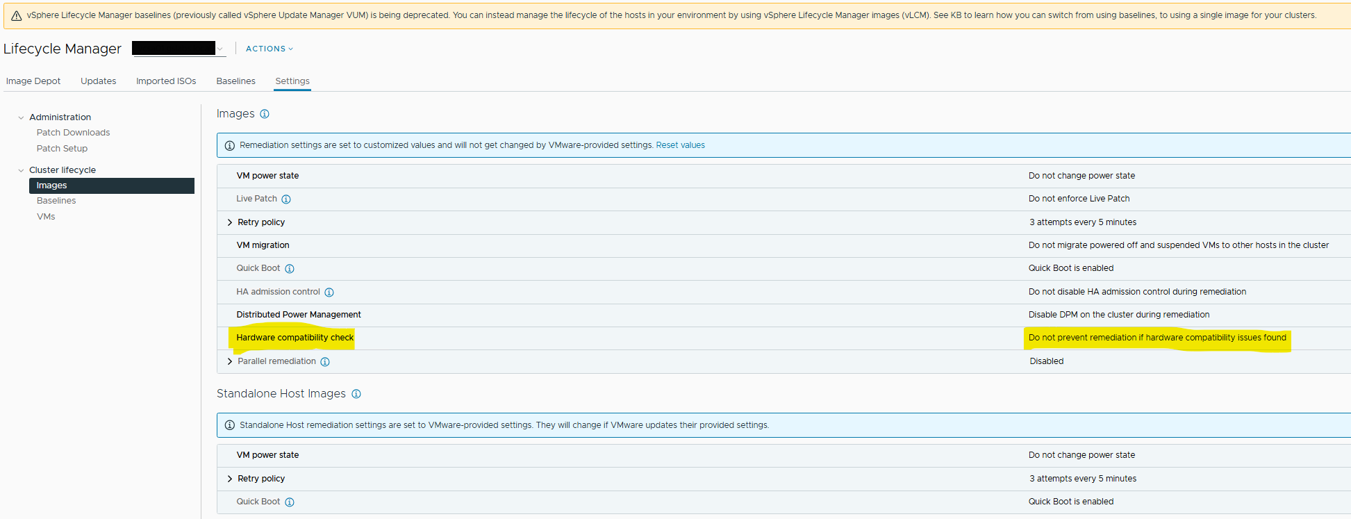

  1. Log in to the vSphere Client.
  2. Navigate to Lifecycle Manager > Settings.
  3. Under Cluster Lifecycle, select Images.

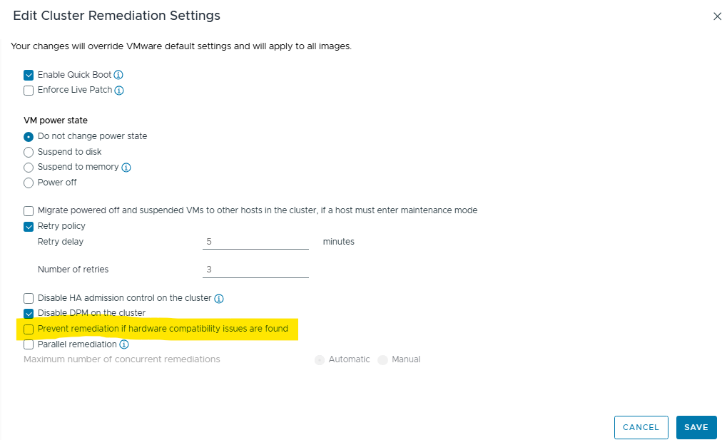

  4. Click Edit and locate the Hardware Compatibility Check section.
  5. Uncheck the box "Prevent remediation if hardware compatibility issues are found".
    This will change the "Hardware compatibility check" to "Do not prevent remediation if hardware compatibility issues found"
  6. Re-attempt the remediation pre-check.
