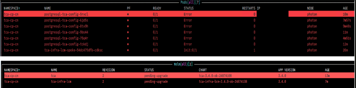

  • Post TCA-CP upgrade to 5.1 the UI status shows as successful:
  • After the reboot of the appliance from the tca-cp console the system pods status shows Error | Pending:
  • TCA-CP is connected to two TCA-M which is not supported. (Or at least it was re-assigned from one TCA-M to another and some garbage left in the database)
