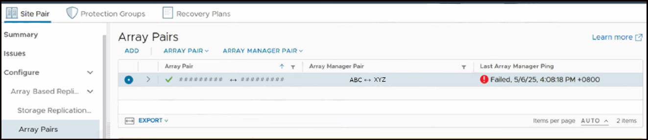

  • From Site recovery UI > Site Pair > Array Pairs > " Array Manager ping in failed state" as below:
  • Device discovery fails with the error message: "SRA command 'discoverdDevices' failed"
