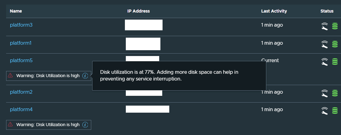

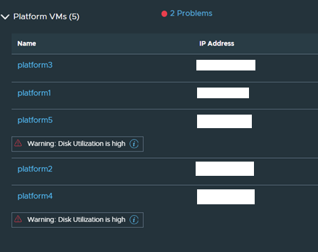

  1. "Warning: Disk Utilization is high" is seen on VCF Operations for Networks Appliances.
  2. Refer to below 2 screenshots:
  3. Above warning can be seen on Clustered or non Clustered VCF Operations for Networks platform node(s)

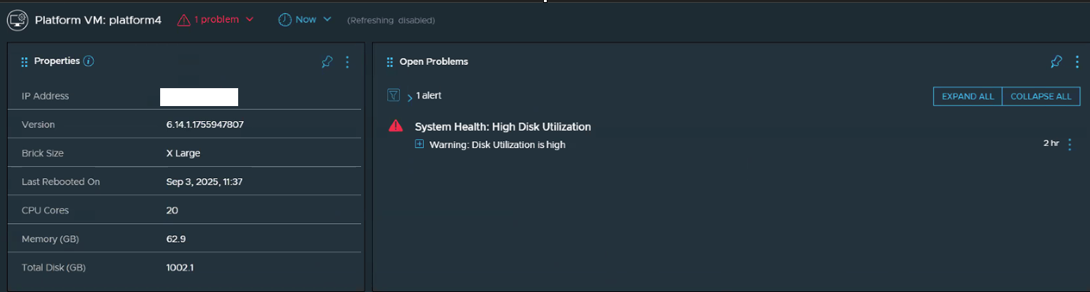

  4. On vCenter when you click edit setting it shows 2 disk added to the appliances as new disk(s), but VCF Operations for Networks detects only 1 TB of disc.
    This can be identified by Navigating to UI and looking at the platform node(s) properties, see screenshot below and see the Total disc shows 1002.1 which is 1 TB.
