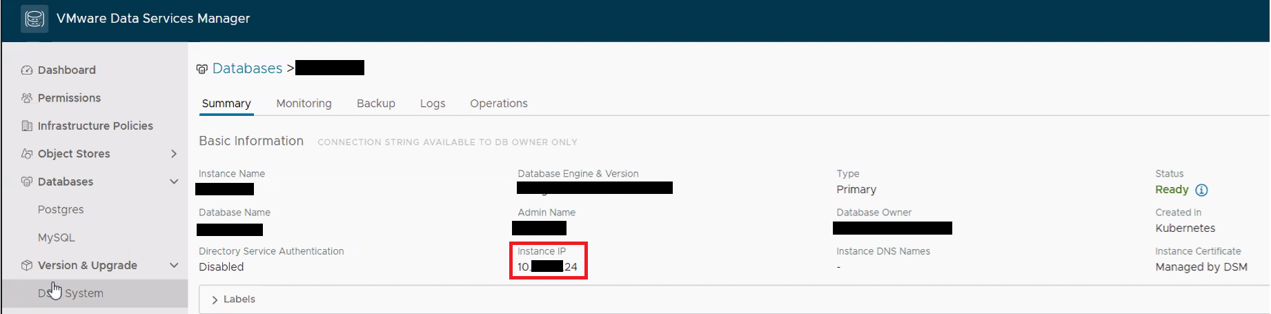

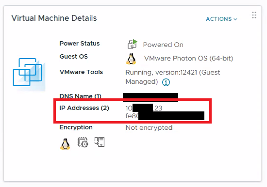

  • The Database Instance IP is missing from the Control Plane VM (Typically has 3 IPs) as seen in the below Screenshots
    Control Plane VM
    Database
