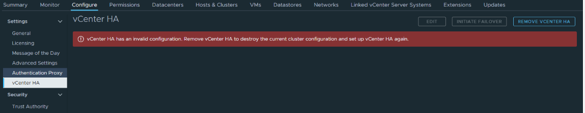

During the deployment of the Passive or Witness nodes, the VCHA fails with the below error "vCenter HA has an invalid configuration. Remove vCenter HA to destroy the current cluster configuration and set up vCenter HA again"

The same error is also seen in vCenter Server 8.0 Update 3, but the clone tasks for passive/witness all succeed.
If that is the case - then the scenario in this KB applies whereby a webclient timeout is experienced causing the error, despite what looks like a successful deployment.
