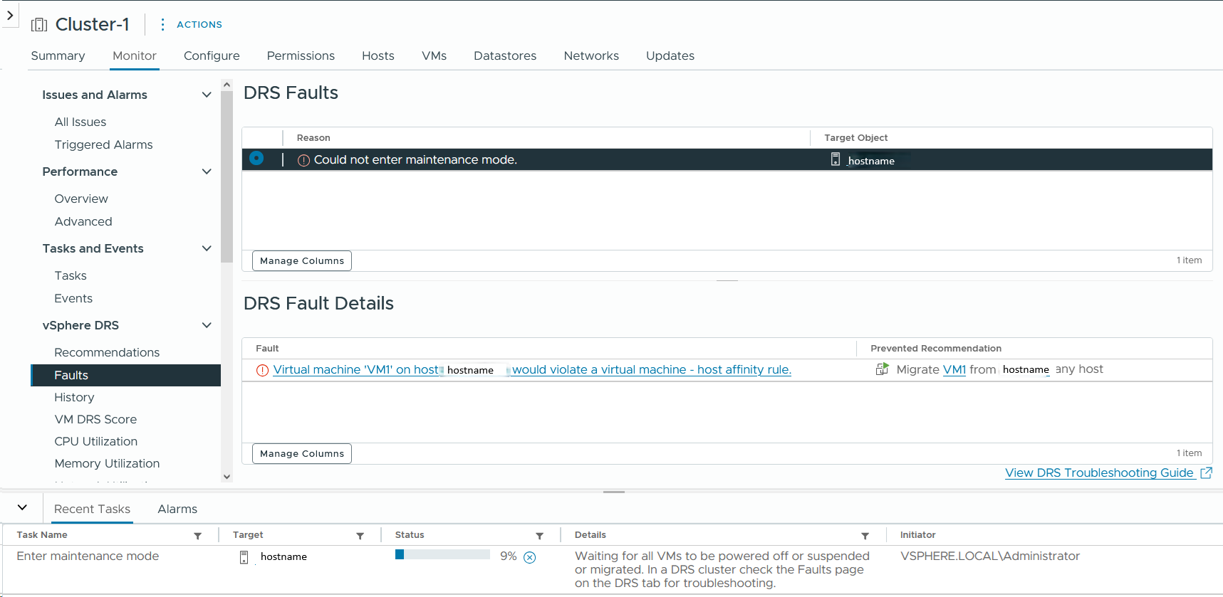

The Enter maintenance mode task for an ESXi host remains in an intermediate state when powered-on virtual machines (VMs) cannot be evacuated. This often occurs in DRS Fully Automated clusters when affinity rules or system-managed VMs prevent automatic migration.

      -->          (vim.fault.VmHostAffinityRuleViolation) {

  • Affinity Rules: Virtual machine-host affinity rules prevent DRS from finding a compatible destination host.

    1. Identify the affinity rule preventing migration in the vSphere Client and either disable or edit it to allow the VM to migrate.
    2. Alternatively, power off the virtual machines on the target ESXi host to allow the task to proceed.
