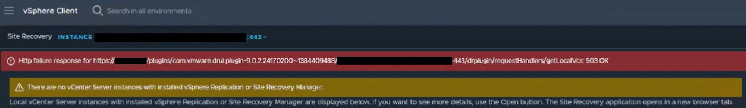

  • A webpage opened in the location vSphere Client > Site Recovery / VMware Live Site Recovery prior to unregistering the vSphere Replication appliance, displays the following error when refreshed:
    "Http failure response for https://<vcenter-fqdn>/plugins/com.vmware.drui.plugin-9.0.2.24170200--1384409448/<vr-fqdn>-443/drplugin/requestHandlers/getLocalVcs: 503 OK"
    "There are no vCenter Server instances with installed vSphere Replication or Site Recovery Manager"

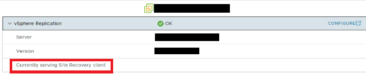

  • This issue is caused because the vSphere Replication appliance was the one serving the Site Recovery client.
  • So once it's unregistered, the plugin stops working and due to this the Site Recovery page on vCenter is not visible and also the registered Site Recovery Manager is not visible.
  • Prior to un-registering the vSphere Replication appliance, it could be seen that the vSphere Replication appliance was serving the Site Recovery client:
  • VMware Live Site Recovery does not to start serving the Site Recovery Client after the vSphere Replication appliance is unregistered.
  • The reason why the vSphere Replication was serving the Site Recovery client is because it was configured in the environment before the VMware Live Site Recovery.
