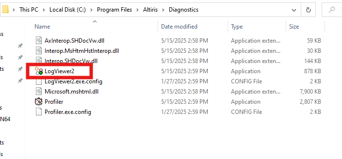

It can be accessed mainly in 2 ways:
  1. On the SMP Server computer, click Start, and then click Symantec > Altiris Log Viewer.
  2. You can also launch it by running the LogViewer2.exe file is located at the following path:
    …\Program Files\Altiris\Diagnostics
    NOTE:
    You can manually copy LogViewer.exe and run it from a client machine or from one of your Site Servers in order to review your agent logs as needed.

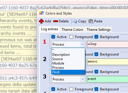

3. Set Schema to Colorize by Host
To visually differentiate log entries from each endpoint:
  1. Navigate to the coloring schema settings within the Altiris Log Viewer.
  2. While there is a default schema that colors by module, edit or create a new schema to colorize by "host." This will assign a unique color to log entries originating from different client machines, site servers, or the NS server, making it easier to track events from specific systems.
