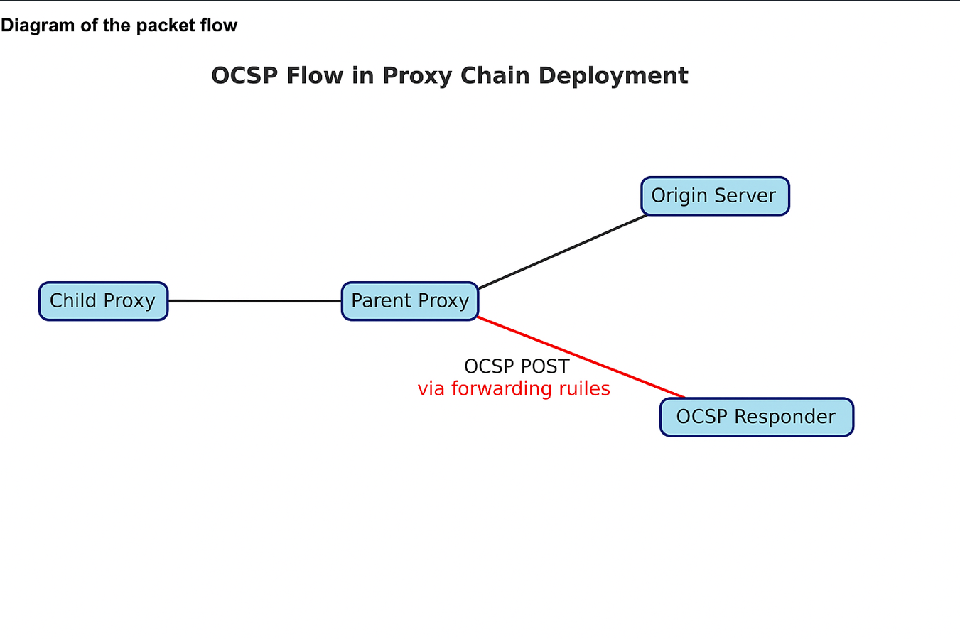

Here’s a clear flow diagram.
  • Child → Parent: Sends the client HTTP request. No OCSP, since the child never sees the real server certificate.
  • Parent → Origin Server: Establishes the TLS session and validates the real certificate.
  • Parent → OCSP Responder: Generates and sends the OCSP POST (routed according to forwarding rules if enabled).
This makes it explicit that only the parent generates OCSP packets, while forwarding simply controls how those packets reach the responder.
