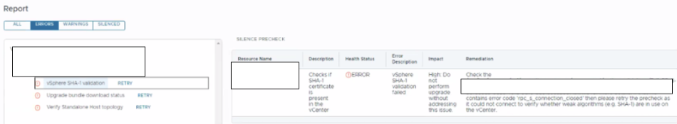

The ESXi host certificate status is out of sync with the SDDC Manager. When updating to vCenter Server 8.0, support for weak signature algorithms (SHA-1) is removed. Renewing the certificate is insufficient if the cached certificate data is not explicitly refreshed on the host.
A manual refresh of the ESXi host certificate from the vSphere Client is required to clear the SHA-1 validation failure.
