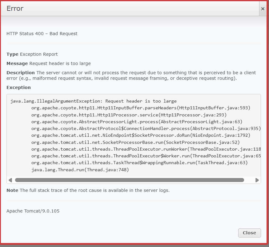

After the upgrade of Nolio from 6.9.1 to 6.9.2 the operation completed successfully but during
the test validation phase all the deployments were in block state in the init phase.
Besides this kind of error for the deployments was found:
Error
HTTP Status 400 - Bad Request
Type
Exception Report
Message
Request header is too large.
Description
The server cannot or will not process the request due to something tha is perceived to be a client
error (e.g., malformed request syntax, invalid request message framing, or deceptive request routing).
Exception
java.lang.IllegalArgumentException: Request header is too large
 at org.apache.coyote.http11.Http11InputBuffer.parseHeaders(Http11InputBuffer.java:593)
 at org.apache.coyote.http11.Http11Processor.service(Http11Processor.java:293)
 at org.apache.coyote.AbstractProcessorLight.process(AbstractProcessorLight.java:63)
 at org.apache.coyote.AbstractProtocol$ConnectionHandler.process(AbstractProtocol.java:935)
 at org.apache.tomcat.util.net.NioEndpoint$SocketProcessor.doRun(NioEndpoint.java:1792)
 at org.apache.tomcat.util.net.SocketProcessorBase.run(SocketProcessorBase.java:52)
 at org.apache.tomcat.util.threads.ThreadPoolExecutor.runWorker(ThreadPoolExecutor.java:1189)
 at org.apache.tomcat.util.threads.ThreadPoolExecutor$Worker.run(ThreadPoolExecutor.java:658)
 at org.apache.tomcat.util.threads.TaskThread$WrappingRunnable.run(TaskThread.java:63)
 at java.lang.Thread.run(Thread.java:748)
Note
The full stack trace os the roor cause is available in the server's logs.
Apache Tomcat/9.0.105
Same exception was reported in catalina.out.
Note: Further occurrences of HTTP request parsing errors will be logged at DEBUG level.
