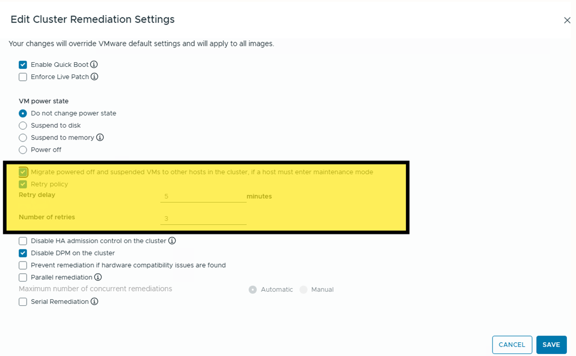

The import guardrail validation fails due to a configuration mismatch between vCenter Server and SDDC Manager:
  • vCenter Server Setting: The option Migrate powered off and suspended VMs to other hosts in the cluster, if a host must enter maintenance mode is currently disabled.
  • SDDC Manager Requirement: The default ESXi upgrade policy requires this VM migration option to be enabled.

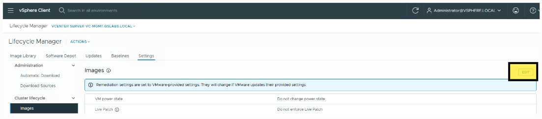

Configure the remediation settings within vCenter Server:
  1. Lifecycle Manager (Global).
    1. Log in to the target vCenter Server.
    2. Navigate to Lifecycle Manager > Settings.
    3. Under Cluster Lifecycle, select Image and click Edit.
    4. Enable Migrate powered off and suspended VMs to other hosts in the cluster, if a host must enter maintenance mode.
    5. Enable Retry policy (if not already selected) and configure:
      1. Retry delay: 5 minutes
      2. Number of retries: 3
    6. Save the changes.

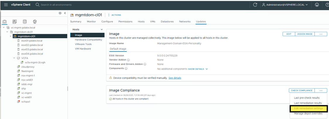

  2. Updates tab at cluster level.
    1. Select the target Cluster.
    2. Navigate to Updates > Hosts > Image.
    3. Under Image Compliance, click on ellipsis on the right > Edit remediation settings.
  3. Retry the import or the inventory sync task.
