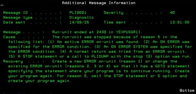

When the 'U' (Usage) option is sent, this error appears:
Run-unit ended at 2439 in YEXPUSGR1I
Message ID: PLI9001
Severity: 40 (means unrecoverable)
Message: Run-unit ended at 2439 in YEXPUSGR1I
Cause: The run-unit was stopped because of reason 5 in the following list: ... (5) A STOP statement or a call to PLIDUMP with the stop (S) option was run.
Recovery: ... For reason 5, omit the STOP statement or S option and create your program again.
2E 8.7.4
This problem happens on rare occasions.  Root cause has not been determined.
It is recommended to check all models to ensure that they have been properly upgraded to 8.7.4.  One way to do this is to look for the new features such as the "*DIFF" function.  Also check to be sure the 8.7.4 libraries are moved in the model's library list to appear before the 8.7 libraries.
