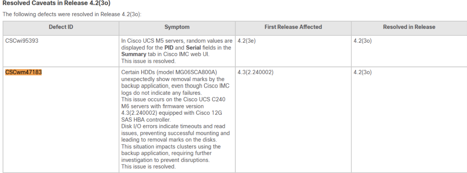

The issue is caused by a hardware firmware-level defect in the Cisco storage controller (Cisco Bug ID: CSCwm47183). When an HDD begins to degrade, the controller firmware fails to correctly isolate the disk, causing the Virtual Drive (VD) to enter an inconsistent or failed state. The upgrade to ESXi 7.x alters how the operating system handles I/O latency and failure paths, which exposes this pre-existing latent hardware bug more frequently.
  • Reach out to Cisco to review and upgrade the Cisco storage controller firmware to version 4.3(2.250016) or a later supported release to resolve Cisco defect CSCwm47183.

https://bst.cisco.com/quickview/bug/CSCwm47183
