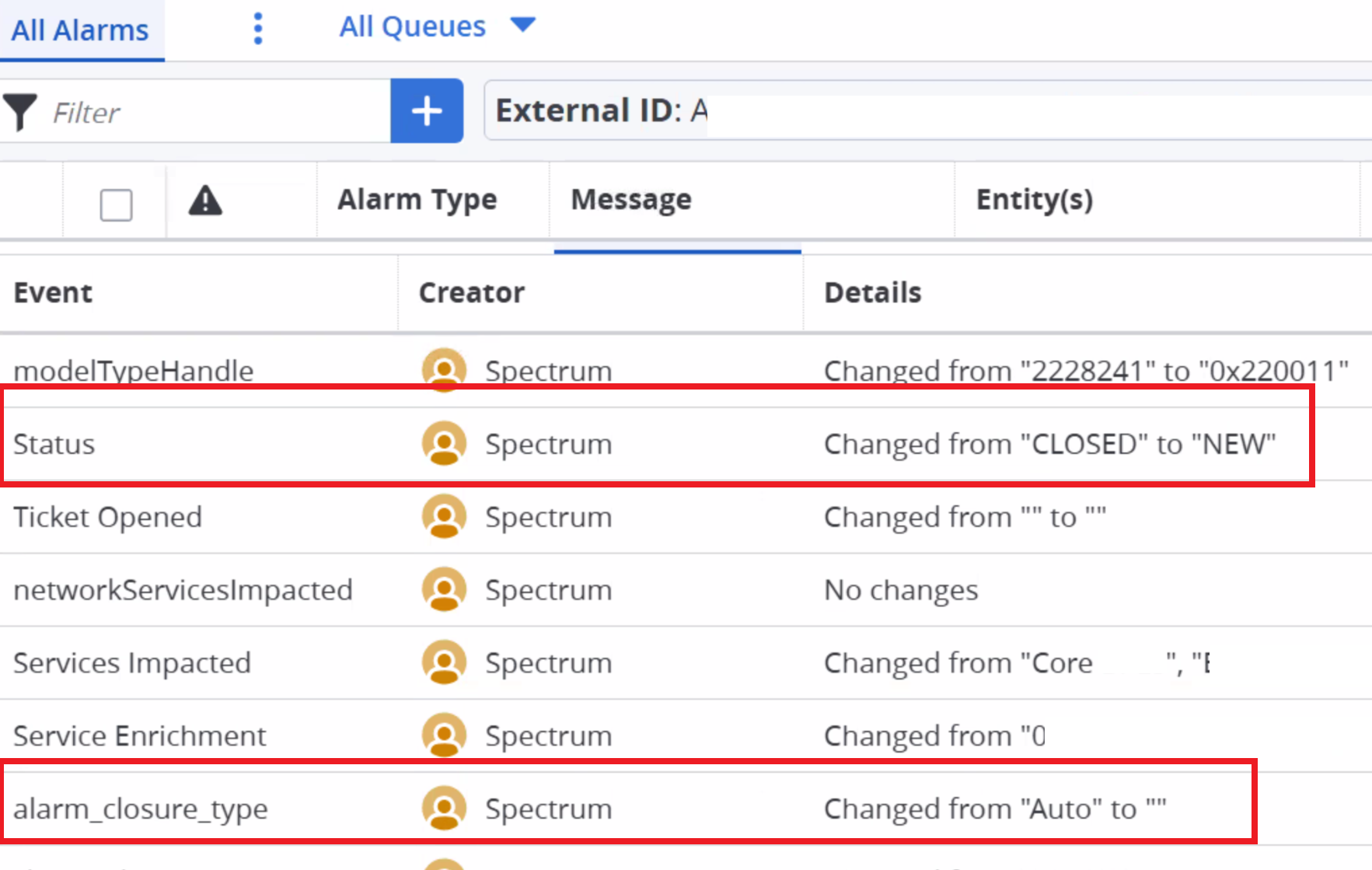

Alarms autoclosure feature and reopen are causing Services not to be linked with the correct alarms
If there is no update of the alarm after x days the alarm will be closed. If any updae comes it will reopen the alarm.
From Alarm Lifecycle events, the alarms status are coming as NEW instead of UPDATED:

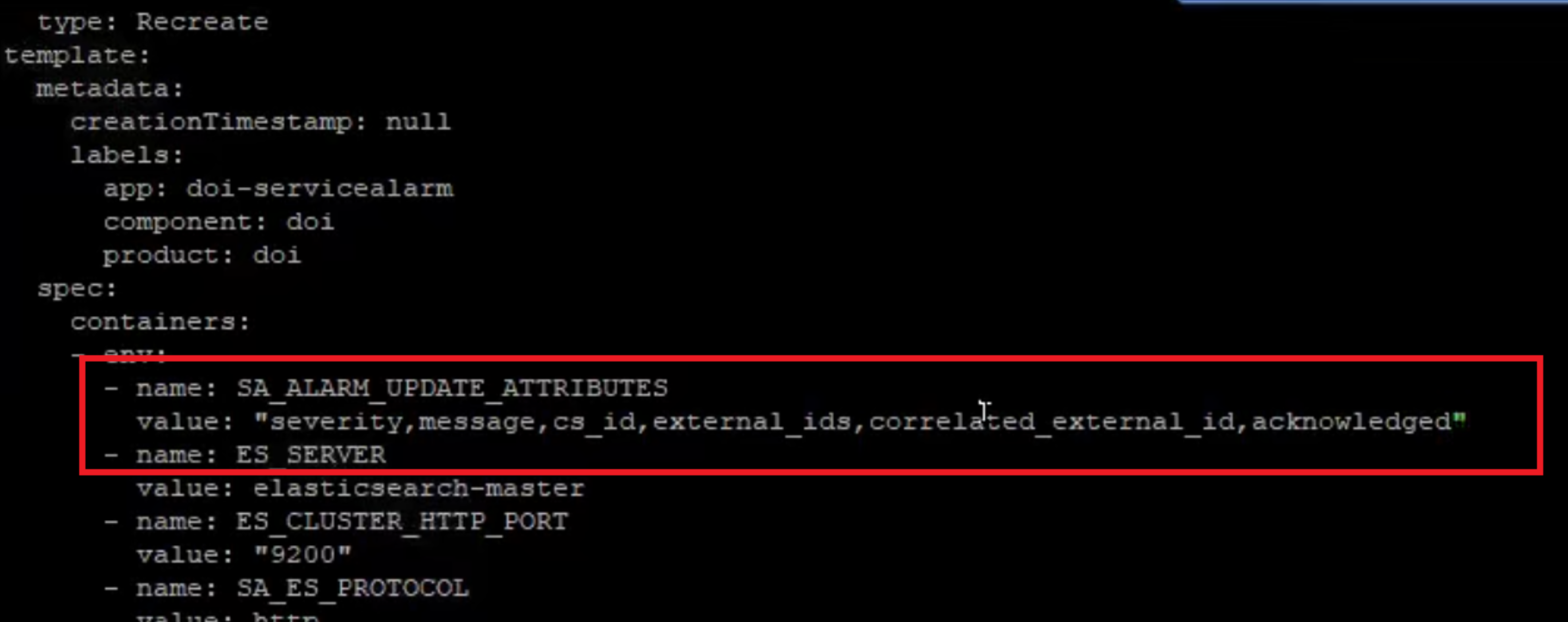

   1) Updated the doi-servivcealarm deployment
   - Add the acknowledge attribute to the SA_ALARM_UPDATE_ATTRIBUTES env variable:
