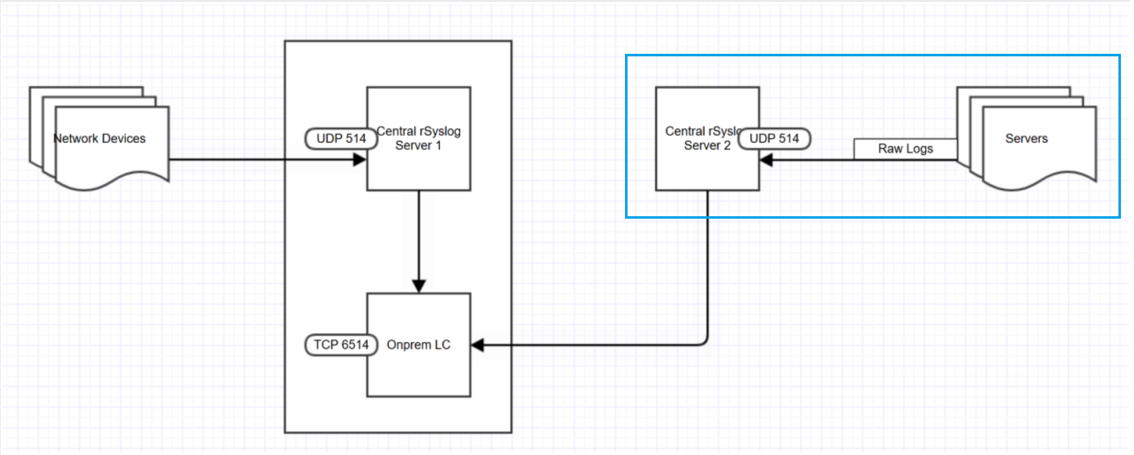

I need to send raw syslog data from multiple spectrum servers to a Central rsyslog which then decorate the data with dxo2 tenant information and forward it to the LogCollector for data ingestion to dxo2. I have Enabled Centralized Syslog Collection for Network Devices with Rsyslog as per below diagram however, in the logcollector log I see the below ParserError:

Incorrectly configuration of Servers syslog, they were sending data to the "Log Collector" instead to the "Central syslog server" hence the ParsingError.
Update the Servers rsyslog port configuration. Contact your Application Team.
