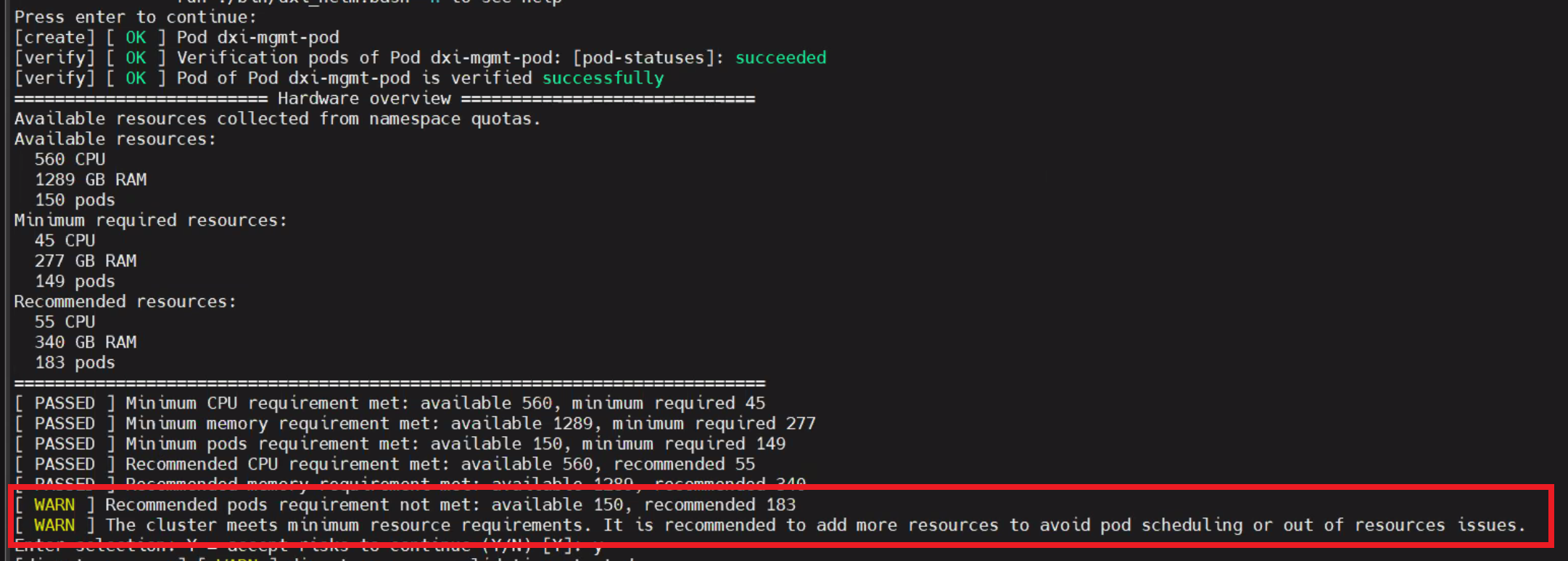

I am installing DX O2 OnPremise and I get a warning message during the resource check:
[ WARN ] Recommended pods requirement not met: available 150, recommended 183
[WARN] The cluster meets minimum resource requirements. It is recommended to add more resources to avoid pod scheduling or out of resources issues.
DX O2 OnPremise
Restriction on the quota, you can check the limits using:
oc get quota -n <your-namespace-name>
Output example:
Contact your Openshift Administrator for assistance
In the meantime, this a warning you can continue with the installation
