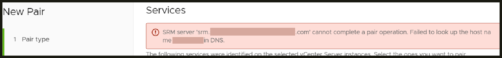

  • Site pairing is failing with below errors on site recovery manager UI.
SRM server '####' cannot complete a pair operation. Failed to look up the host name '#####' in DNS.
