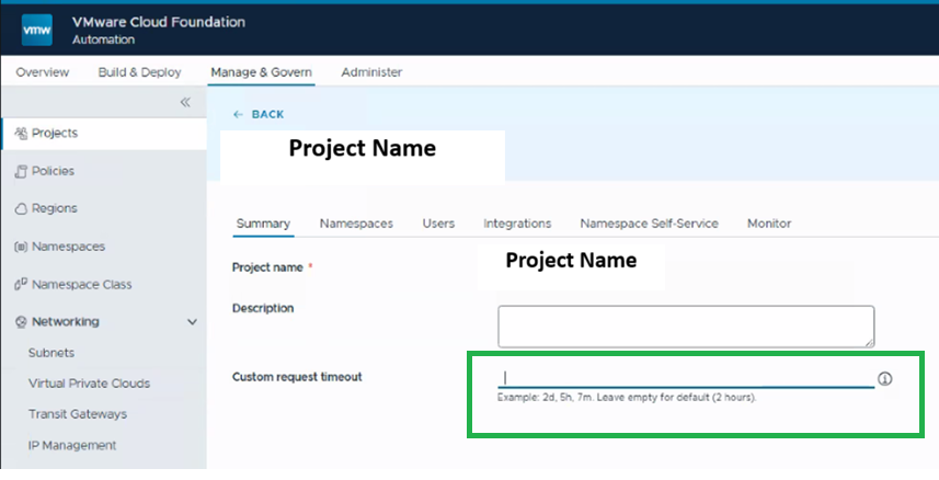

    Modify the Project Timeout Value for VCFA 9.X:
  • Log in to the VCF Automation (VCFA) Tenant portal.
  • Navigate to Manage and Govern > Projects.
  • Select the specific project associated with the failing deployment.
  • On the Summary tab, locate the Custom request timeout field.
  • Increase the timeout value (in minutes) to a duration that safely accommodates your long-running deployment (e.g., 180 or 240).
  • Save the configuration changes to the Project.
  • Submit a new deployment request to verify the issue is resolved.
